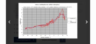

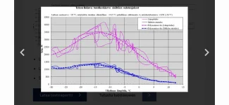

Air heat pumps are great for winter heating and are very popular in the Nordic countries, for a good reason.
Here’s for example Mitsubishi Electric EF25. It has COP of 2 even at -30C (-22F). (meaning that with 1kWh of electricity you get 2kWh of heat).
From the figures:
-Blue = input power (electricity)
-Purple = output power (heat)
-Red = COP = heating efficiency calculated from the two previous values
https://scanoffice.fi/vttn-testiraportit-ilmalampopumppuvertailu/
