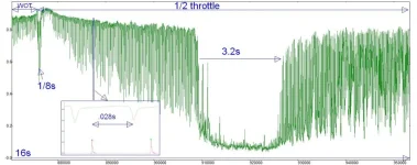

I added O2 sensors and had the Holley reman'd to spec so I'm confident that the performance is OEM (slightly rich). The data shows rich at WOT, slightly rich at 1/2 and very lean with plates closed downhill and 22"Hg. Rick Walker carbs does a perfect job.
View attachment 123912 View attachment 123914
That RV is great!
Help me understand your chart and how it relates to ratios like 14.7.
I tuned a holley with a wide band, it was fun to watch the different circuits kick in. Nice tool for tuning.

That RV is great!
With narrowband it's an S-curve, 1.0 rich and .4 to .6 is about stoic.
Most ECUs don't care about keeping perfect 14.7 (and rarely do for good reasons). Here in 10% ethanol land stoic is more like 13.x anyway so I want it richer for that and which puts it out of the top of the vertical middle plot. Then also, I live at altitude which implies I want leaner.
And, to top it off, the 413 RV models are stagger-jetted
Thank you for the details.
