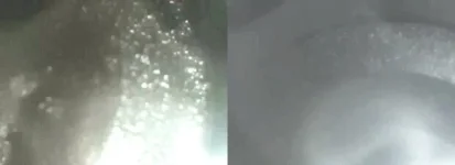

When I first bought it I used MMO and Seafoam down the carb too until the intake was clean and pistons had no carbon. I scoped them with my snake cam:
