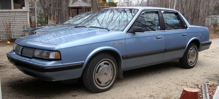

Happy February! I was on my local craigslist when i stumbled up on a pretty decent looking, older lady owned 1990 Oldsmobile Cutless Ciera S. It has the same engine, and transmission as in my buick, the 3300, and 3 speed Th125C or 3t40. It only has 90K miles on it, but it was not running. I picked it up for a song and a decent conversation, and had to tow it back home. The fuel pump was bad, so replaced that along with the strainer and fuel filter. car started right up. It sounds pretty good, but has slight sludge
and valve ticks. It sounds like a modern Honda 3.2/3.5L on 0W20.. It drives really well, has a little more power then my 220K buick, and has no rust... Alright now the issues i am having is the torque converter does not seem to engage all the time when it should above 35MPH. I also have a Code 26 sometimes... I changed out the fluid and filter with maxlife and it made a decent difference in the way it shifted/downshifted. When the TC does lock it is silky smooth, and some times will lock and unlock and work 100% normal for miles, so i dont think its a mechanical issue. The transmission shifts pretty good, slightly firm under real hard throttle, but nothing over the top.
