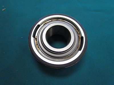

It does not get wet. Basically it is a bearing that is pressed into the transom plate on out drive. The input shaft of the outdrive runs through the bearing into the engine coupler. So what is going on is that you pretty much have the crank shaft spinning the input shaft of the drive unit. The RPMS are 1:1 of what the engine is. So its always changing, and ranges from ~800rpm to 5600rpm. I don't *think* it see the lateral forces that a normal wheel bearing would see since it is not supporting any weight. Here are a couple of pictures. I think the Dominator may be the way to go, however I don't know what its life is like being a racing product.
The Yellow is the bearing. The Red is where the shaft runs into. Through the bearing and into the Red.
The blue shaft is the input shaft of the drive. Runs through and spins inside the bearing.
Looking into the gimble housing.
The bearing itself.
