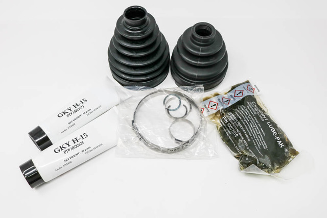

Found this one online with tubes and a packet:
Having a hard time finding any of the part numbers on the grease packets available separately and I don't really want to buy an entire kit just for grease, so I'm on the hunt for the closest matching formulated grease for the inner tripod

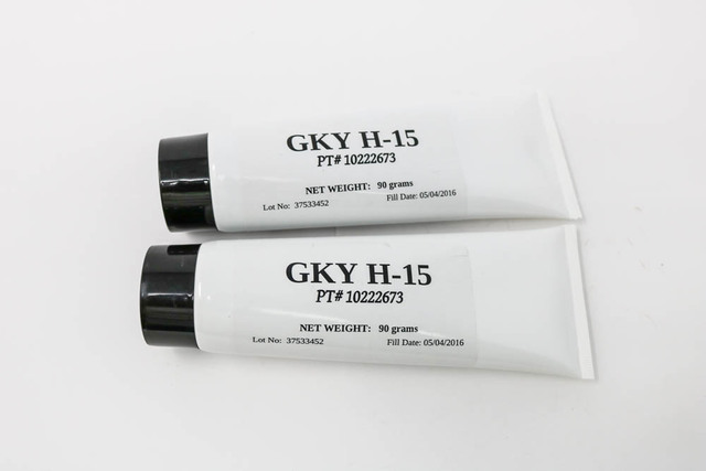

I have no idea myself, but going the GKY H-15 part number in the boot kit posted above (assuming they are in fact for the inner joint), I found this data sheet which appears to be polyurea
https://fcsdchemicalsandlubricants.com/msds/usGKYH-15us_supplier.pdf
So now I'm curious as to what is actually compatible and feel even more confused than when I started lol
