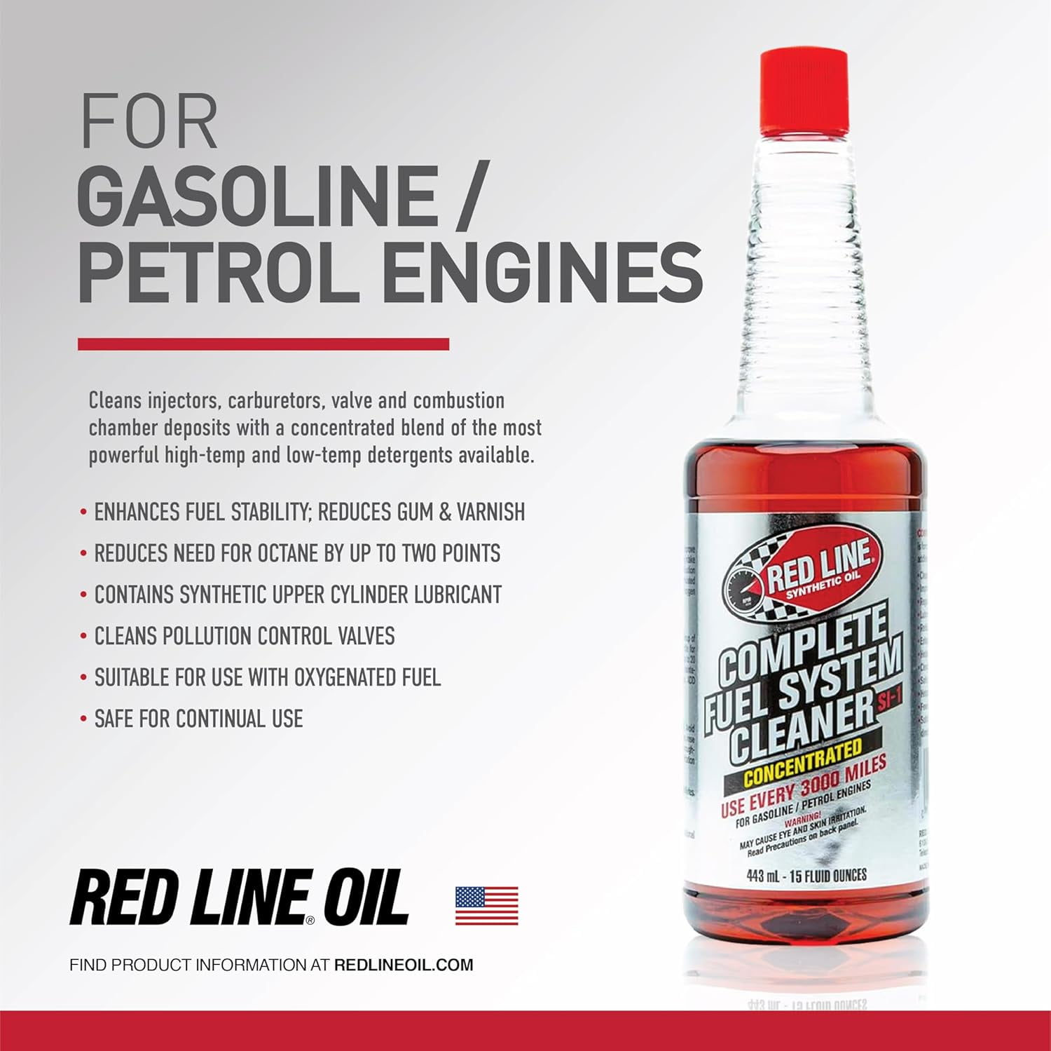

Red-Line claims that SI-1 has an upper cylinder lubricant.
