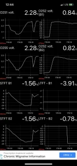

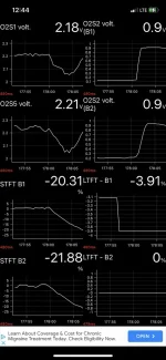

Final symptom and this really has me perplexed. I was finally able to watch my fuel trims just as i was getting a slight stall/no down shift at highway speed. —- all fuel trims disappear/go to zero for a few seconds.

Didn’t notice before but fuel trim goes to 0 every time I hit the gas anyway…with no issues.
However. The A/F voltage is consistently 2.25 ish which is apparently very rich. Hitting the gas doesn’t lower that voltage very much. Letting off the gas will send it up to about 3.5 (going lean and is appropriate)
I don’t see both A/F sensors going bad at the same time. Which leads me back to the MAF sensor..especially when it gets hot?
Watching fuel trims go up and down while idling in short order

Stuck injectors? Does the exhaust smell rich? Your stft on one bank is -20%, meaning the computer is pulling fuel, which means unmetered fuel is getting into the engine or your 02 sensors/maf/other sensors are reading wrong. You could try unplugging the 02 sensors, which will default to a base fuel map. If your problems go away with the 02 sensors unplugged then it's most likely the 02 sensors. You can do the same with other sensors, although some cars won't run if one or more sensors are unplugged.
