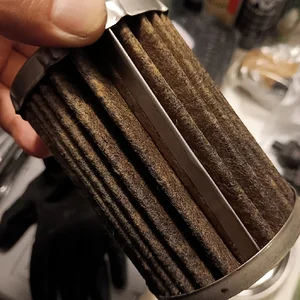

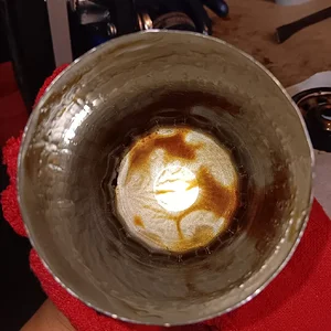

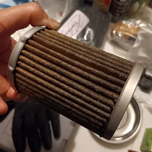

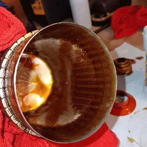

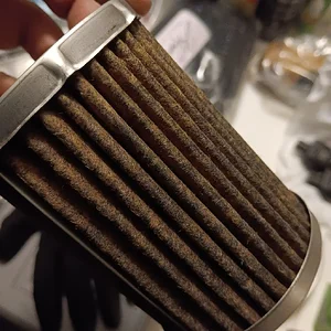

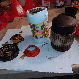

Fram FS3600 C&P with magnet array, 10,055 miles.
Oct 3, 2023
891
This was pulled out a few months ago running on HPL HDEO 5W-40 for about 13 months. I was lazy or busy with life and didn't bother to post it in time until sorting out my phone camera photos today. Didn't expect this to work too effectively in capturing debris, car still runs fine and does not eat oil going through the same driving habbits. Currently running HPL SuperCar 5W-40 with Fleetguard LF16011 about 4968 miles and about to do a filter swap soon on that too but did not put magnets on that one but does have one at the sump drain plug.
That looks pretty cool how it accumulated inside the can. However, it makes me think if we're not letting the media catch it then why not just run magnets only. 😅
I'd say a few for visual inspection is good. You have a clear view...ha!
Fascinating. That a significant amount of stuff the magnets caught. And with the media wicked it almost looks like it could go another 10k.
It always raises the question in my mind: where are those particles if not caught by the magnet? In the media? Floating in the engine? Hiding in a crevice somewhere?
You can get oil analysis saying super low wear metals but I have to wonder if those low wear metals are just the stuff too small to matter, while the magnet is catching stuff the UOA can't see.
I've sampled numerous magnet sludge samples and nearly all of the magnetic material is much smaller than 1 micron. So it would likely keep floating in the oil, maybe get caught in the filter, Possibly settle in the oil pan, contribute to sludge build up all over the engine, continue to cause wear, ect. Nothing positive.

I’m sure your “why not just run magnets only” comment was in jest. But, not all contaminants are ferrous.
I've sampled numerous magnet sludge samples and nearly all of the magnetic material is much smaller than 1 micron. So it would likely keep floating in the oil, maybe get caught in the filter, Possibly settle in the oil pan, contribute to sludge build up.
Can you provide more info on this? How did you sample the sludge? I’m intrigued. I run a magnetic drain plug on all of my vehicles. And, I run also run a FilterMag on the oil filter of my Frontier.
I took magnet sludge smeared it on a microscope scale and looked at it under my microscope.

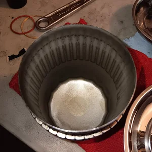

Are these just regular neodymium magnets from Amazon? I heard in the past that you had to use some kind of special high temp (N52 rating?) neo magnets due to the oil temp being so high for such a long duration of time that it would reduce the strength the ones that do not have this rating.
Your magnets do not seem to have suffered from this, and caught about the same amount as my FilterMag brand that is much more expensive.

These are N42SH which are good up to 150C they are not cheap and cost about 4 dollars per magnet, i bought a pack of 50 last year on a discount sale at K&J Magnetics. I have run other exotic magnetic materials in the past which include SmCo32 disc but unfortunately the test vehicle was totaled in a accident late 2024 and was unable to reach the milestone for oil sampling.

Lots of that ferrous material that was caught by the magnets would be too small to all be caught by the filter, even with the 99% @ 20u efficiency.
How many miles are on that engine? Seems like quite a bit of ferrous material, but maybe it's visually deceiving. So no magnetic drain plug on this one, only the filter magnets?
Suspended in the oil and going round and round through the oiling system.
Running magnets like this can actually decrease the ferrous wear metals in a UOA since the UOA is looking at particles 5u and smaller, which many of those particles caught on the magnet will be. If all of that debris caught by the magnets was put back into the oil and a UOA was taken, they would show up in the UOA.
Running magnets like this can actually decrease the ferrous wear metals in a UOA since the UOA is looking at particles 5u and smaller, which many of those particles caught on the magnet will be. It all of that debris caught by the magnets was put back into the oil and a UOA was taken, they would show up in the UOA.
In a healthy engine virtually all the magnet goup bits are smaller than 5mu.
Photo of odometer when the oil and filter was change, subtract 10,055 miles from it. This is the first HPL oil run since it was purchased to replace the old test vehicle.
This run did not have a magnetic drain plug at the time. The one with the Fleetguard LF16011 does currently. Which i will pull out at 140k miles and swap in a Donaldson Synteq P551132 with 8 N42SH disc magnets added on the baseplate for direct oil flow contact and sample to lab at 10k maybe depending what comes out of the Fleetguard stratapore filter thats in right now.
