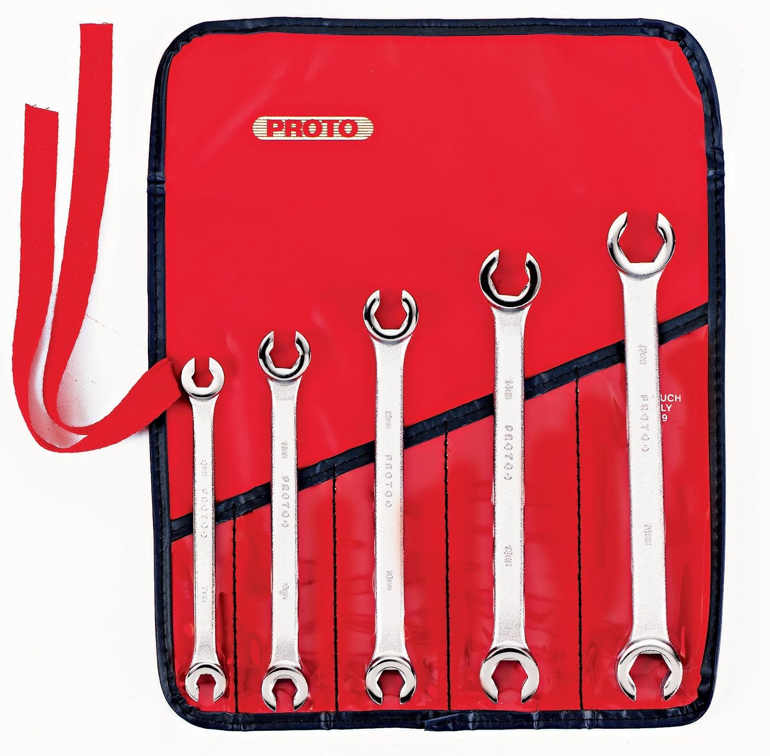

I noticed that the Proto wrench end is configured much different than most of the others. Do you have experience with these two different styles and have any comment if one works better in regards to not rounding flare nuts? Sorry for the large pictures!
VS.
The Proto uses TorquePlus that grips the side of the fastener better.
It works very well. Most companies now have this kind of system with different names.
The Proto is also "Made in USA". At this level there are no "bad" tools just different finishes and features.
In this case I give the nod to the Proto. Yes I have used both and a few others.
Thank you.
I am aware of the "flank drive" features. The Proto design grabs 4 corners(2 near the beam=stronger?) while the others grab 5 corners(1 near beam).

The so called "flank drive" which was a Snap-On held patent is said to round fasteners less. I believe that may be true, especially on softer fasteners, however, I have not done any studies, nor have I seen any peer reviewed studies.

I don't know if there is an advantage to one or the other or how much the 2 at the end of the flair contribute to the strength or grip if any.
The Proto may be able to get on some rubber line fittings easier with its wider throat but I cant say I ever ran into any problems with either style.
I see in the garage journal comments some are referring to "new" and "old" style I don't believe that to be the case.
Stahlwille another premium German brand is using the same style as Proto, I would bet money on them tossing the design if their engineering thought the design inferior in any way, ditto Proto.
Both companies have been doing this for donkeys years and doing it well, because HF copies a style that Proto uses and is junk doesn't mean the design is bad or Proto will suffer the same fate.
It means HF made a piece of junk with cheap steel nothing more.
IMHO both designs are equally capable of holding the fastener as long as the steel is strong enough to prevent spreading, again at this level that should not come into question.
One thing that does come into question at this quality level of wrench is how much grip is lost to the opening that the line fits through. My opinion is that for a flare-nut wrench the loss of a whole side is worse than the loss of a corner. I also feel that a feature such as OptiDrive or TorquePlus is little if any walue and FlankDrive Plus is a negative on this type of wrench.
