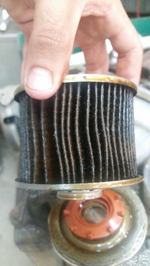

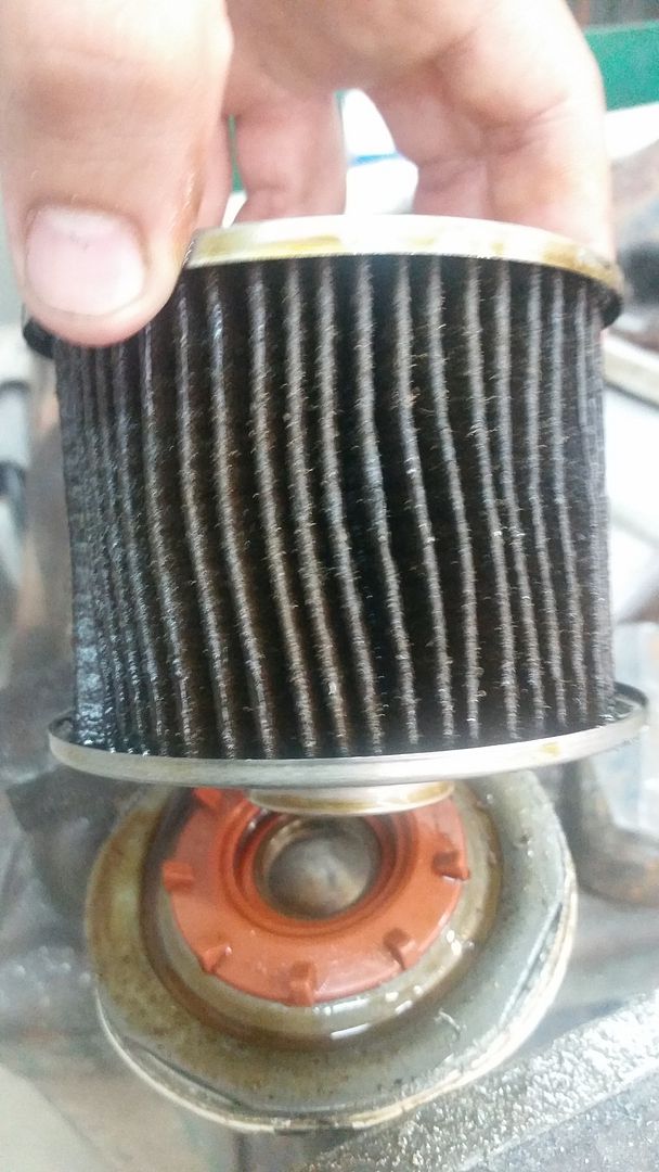

Got this of a family members 2011 5.4 f150 has approximately 5k oil used was motorcraft 5w20 synblend this truck is severely short tripped it's a little under 2 miles to her work 4times a day and city miles mostly occasional trip 30 miles to Sam's Club filter looks really good no tears pleats are kind of sloppy
