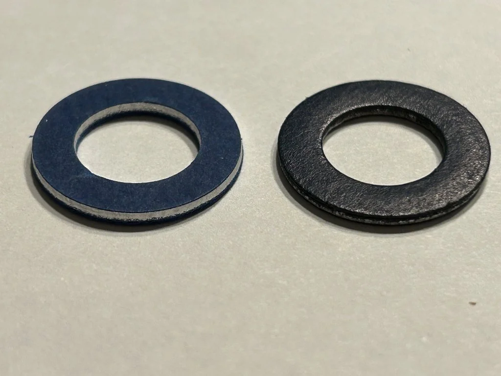

I have a number of these washers and they have changed over the years which might be part of the recent debates.
The one on the left is from Brunswick Automotive, years ago
The one on the right is from the local Toyota dealer - but I did order online and had shipped last time they had the 20% off sale, whenever that was. I have not tried those yet but they are thinner. They look black in my pic, but they are a dark blue.
