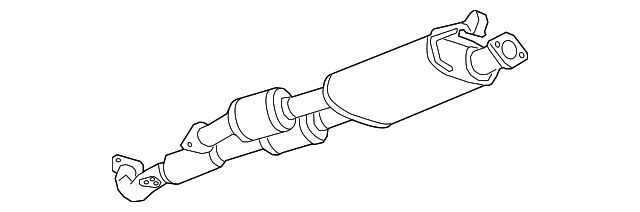

Nagging exhaust system problems seem to be the bulk of the complaints you hear of with the 2018-2023 Traverse. It's overly complicated IMO. The catalytic converters are bolted directly to the cylinder heads of this 3.6L like most of them are now. No exhaust manifolds. This seems to be working out for most make/models, but this GM 3.6 can form cracks on the outlet elbow of the bank one catalytic converter. You can generally get that covered by the fed emissions warranty. Then there's the front and mid assembly that contains two flex joints that will eventually form pinhole leaks, two "clean up" catalytic converters and a resonator. Most of it is one big assembly (see pic below). This is a $500-600 part. That outlet flange is the one where the bolts rusted apart on mine. Then there's the rear dual muffler assembly that takes you all the way to the rear at a cost of $800.
The small triangular image with the 3 holes to the lower left of the pic below is part of a bracket that joins the two front pipes together (bank 2 front pipe is separate). This bracket can tear away from the pipe to due "poor welds". There is a TSB that covers just the bank 2 pipe in the event this happens and it happens a lot to these.
