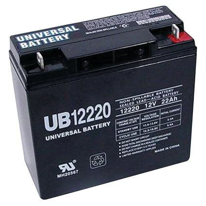

and this UPG battery:
I've weighed many a battery, they rarely match their product descriptions.
The 16Ah odyssey pc680 supposedly weighs 15.4 Lbs, which would make it a lot more robust a battery rated at 22Ah and 14Lbs.
If one wanted a small top quality high cca lead acid battery and was willing to Pay made in USA prices Odyssey TPPL have small sizes and can accept very large charging currents, whereas the UPG batteries generally limit to 1/3 the AH rating, 3.3 amps max for a 10Ah battery.
Limit voltage to 14.7v and the depleted 18AH Odyssey AGm battery can be hooked to a 40 amp charging source. In fact Odyssey indicates this is the best way to charge when deeply cycled or is in need of a reconditioning because of noticeable capacity loss.
I'd not do that to a depleted UPG AGM battery unless as an experiment to see when the sides bulge, thermal runaway begins and when the vents pop.
