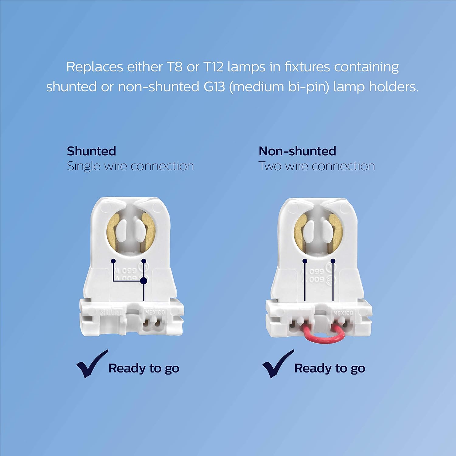

Anyone tried this before? I'm kind of confused because some of these claim there's a ballast bypass, although I'm not sure what that means. As far as I can tell, the ballast compatibility guides are for setups that are guaranteed to work between the LED tubes and ballasts. I guess I can't use T8 tubes since they're not compatible with the ballasts, but I can use 13/14 watts T8 sized LED tubes.
So any opinions on whether I should get an LED replacement? I believe they should use less than half the power and last considerably longer. Not sure about how directional they are though.
Ballast bypass means your hooking power directly to the sockets. Have to watch though as some sockets are shunted.

Well - I can put this off because it's working for the time being. However, I'm thinking of replacing them with bypass LEDs on the advice of many posting here. Not sure if I'll get double-ended or single-ended, but it looks like the Philips MainsFit versions are double-ended. It looks like the way they work is fairly simple - hot on one end and neutral on the other end. They require either shunted or bridged non-shunted. sockets. The only problem seems to be where to just get a pair. Amazon.com sells two varieties of 4 ft ones, but only in 4 packs. Kind of a dilemma since this is a single pair setup and I have no other places where I would need a 4ft tube. I'll keep my eye out if anything similar is sold in singles or pairs.
https://www.amazon.com/Philips-LED-542506-MainsFit-Ballast/dp/B07KK56DDR
I don't really feel like taking out everything and putting in specific LED lights since I don't want to repaint and leave any holes.
So here's the plan for a double-ended setup......
1) Take out the entire ballast including all the captive wires and sockets connected to those wires, keeping everything connected. I had a heck of a time pulling out the wires from a socket to reuse. I'm going to put it aside and keep all those just in case I need to put all this stuff back in, and it's going to be a pain connecting it to stubby wires.
2) I'll go out and get new G13 sockets. They were only $2 a pair where I got my replacements. The odd thing was that they fit a little bit loose compared to the ones they replaced but were fine once everything was screwed in tight. It slid into a piece of sheet metal that was then clamped to the fixture. Then I would need to bridge (effectively shunt) them like they show here:
[Linked Image]
3) Get some 18 gauge solid copper white and black wiring. I think I can buy it by the foot. I figure keep the colors simple - matching the mains colors. Probably a good idea to use a single wire going to each socket, which will be bridged.
4) Connect the hot wires via a cap connector (or do push-in connectors work better?) on one end and the neutral wires to the opposite end.
5) Insert the tubes and hope to heck that I don't burn my house down.

But my plan right now is to get doubled-ended ballast bypass tubes where I'll shunt the sockets myself with short lengths of wire. Then connect two black wires to one end, then two white wires to the other. Maybe also leave a note on the setup on the fixture, even if it's just so I can keep it straight.
The fixture is in good condition although the original sockets are slightly blackened. I believe it's 70s era although. Y house is late 40s. I replaced the original magnetic ballast maybe in 2011 with the electronic one I mentioned. I don't even recognize the company. I guess it was one of several small companies that made them. I just went to dispose of household hazardous waste and forgot to get rid of the ballast.
Here's a tip. Before you decide to shunt a nonshunted base with a short wire for a double-ended tube, test the continuity of the led tube's 2 pins on the same end. Most likely you don't even need to connect a short wire from one side to another since the tube already does that for you on the inside. You can connect it with a short wire if you want, though.
