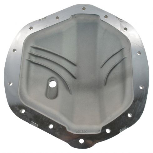

What's really interesting is the interior design of the Ram's factory finned aluminum diff cover. Seems to back up a lot of what Mr. Banks has to say about the interior shape engineering:
[Linked Image]
I was just watching a video featuring a clear differential cover, and I'm starting to see that Gale Banks really is onto something here. In watching the video, the channel for the rings gear moulded into the rear cover definitely appears to be keeping the gear oil focused on the gear ring.
Those little "dams" or "fins" inside of the cover wod likely be there to move outlying hear oil toward the gear ring as well.
I am definitely starting to see how having a large cavity behind the ring gear could be to a detriment of ring gear lubrication. Without that channel, there is no guide for the lube. It's free to sling off as much as it wants, and it doesn't appear that there would be anything to really aid in the gear oil either finding it's way onto the ring gear, or back to the bottom of the case.
They direct oil to the carrier bearings.
There are all sorts of methods used to control where oil (motor and gear) goes in the racing vehicles I consult on. It's reassuring that the FCA Engineers also have an understanding when designing that OEM finned aluminum diff cover.
I can see that. I haven't done any cool new covers for my axle. But I think I'm going to order that cover for my Rams now. Seems like a really trick piece, and my local dealer can get them for me cheap.
