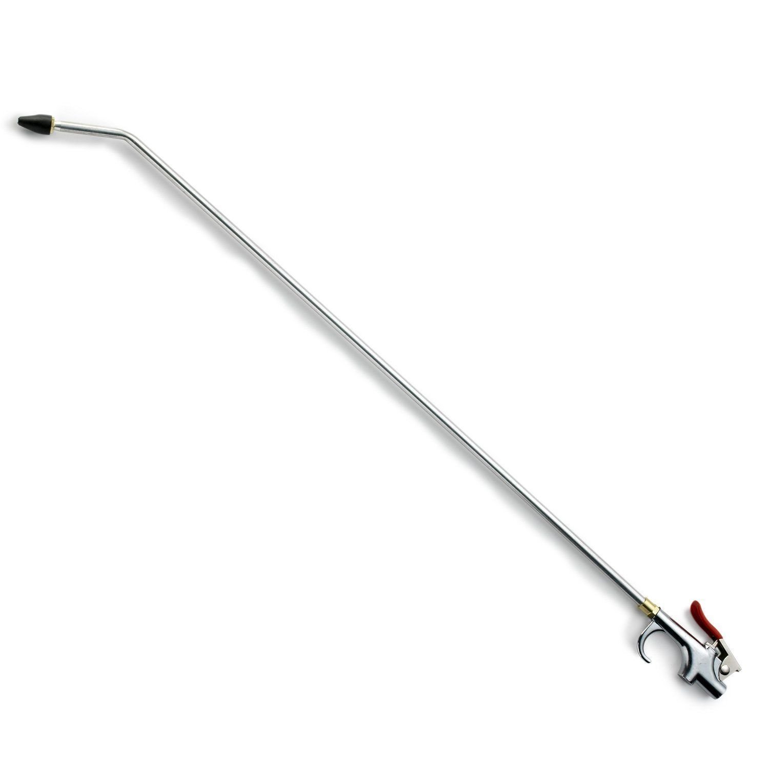

It may not hurt anything in there, but i totally understand wanting to get it out. I'm thinking if you had a really long blow gun tube, you could insert it in the drain hole and push it way in. Let it rip with some air and hope it moves back toward the drain hole with some air escaping the drain hole. Flush afterwards a few times with some oil and hope it comes out with the flush.
Maybe something like this? If you take the tip off and straighten/ bend it to get more length into the pan? I don't know if it would work, just a thought.
Thanks for the write up, i've never used time serts, this was very informative!
[Linked Image]
