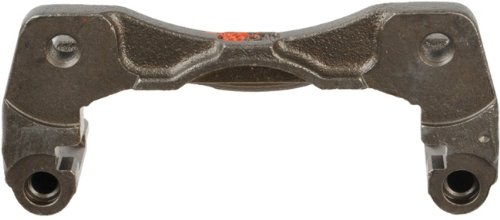

While doing some brake work last weekend, I noticed that two re-manufactured caliper carriers I purchased had different paint/rust-proof finishes. Same company (A1/Cardone), same part number, same box.
One had a "neutral" look to it, much like the description picture online, and the other one looked like it was poorly spray painted silver. The description does have this fine print: "Product appearance and finish may vary, but fit and function remain the same."
Any ideas why? Do they have multiple facilities with varying standards/processes? Which is better?
Either A1 Cardone sourced the parts from different suppliers (I doubt they do all of their rebuilding in house), or they changed their supplier/spec for the finish coating for any number of reasons (but probably cost and availability).

Most NA reman brake calipers are sourced from various different means: from user core exchange to junkyard rotting stuff. When they received these so-called "cores", part of the procedure is to sand-blast the rust off of the units to rid of dirt, grease, rust, etc. and then followed by cleaning processes before some kind of measurements to take place (to see if those "cores" are fit for rebuilds/remains.
Most low-end remans simply have their blasted reman caliper assemblies coated with some kind of oily/waxy based stuff that looks clear, and this coating tends to wear off fairly quickly (esp. in rust belt areas where winter road salt splash will accelerate that).
Certain factory calipers (such as ATE, Nissin, Aisin, Sumitomo, etc.) came originally with some form of anti-rust coating (or already baked in paint). And many times the reman facilities will strip this paint off during sand-blasting process, but not to recoat it afterwards.

Just to be clear, this is only the caliper carrier - the hunk of cast iron that houses the caliper pins.
