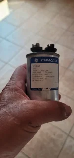

my unit not the op is a 23 year old bryant. all original. never serviced. the capacitor was made by GE. The new one Chinese Junk.

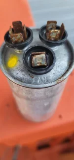

Good pictures of the supposed bad capacitor would be nice. We need to look for bulges, etc if there is nothing obvious wrong with it.

Per your photo... P/N 97f9849 is a 40/5 dual run capacitor - 370v. Do you have a Grainger location nearby. They'll have it in stock. Otherwise find a local HVAC supply house. Quick easy replacement. If that doesn't fix it call in the professional.

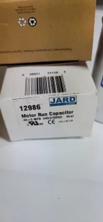

Guys I already replaced the supposed bad bulgeless capacitator . Unit fired right up after replacement the new one was 12 dollars. Thanks

I stand corrected apparently my replacement capacitor was made in God Bless America. That's two items this week I purchased made in USA capacitor and genrac power washer.

The old capacitor looked fine physically- there was no bulging or anything of the sort, nothing about the appearance would have led me to believe it's bad. But I got no capacitance reading on the HERM side, and the fan side was reading 2.5uf instead of 5.
