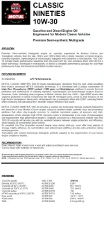

From what i understood i have to look for an oil which has a good amount of ZDDP, saying between 1000 and 1400 PPM. SM and later are no good due ZDDP level around 600. I'm having a very hard time finding any Zinc additive in EU such as HY-PERLUBE ZINC REPLACEMENT, but I instead found the MOTUL CLASSIC NINETIES 10W-30 (spec sheet attached), which is reported to have ZDDP at 1800 PPM, but seems to be too much (btw the MOTUL oil selector tool suggest me this one).
I would like to kindly ask you what do you suggest, and if the MOTUL CLASSIC NINETIES 10W-30 could be a viable solution when mixed with another oil (which one?) to lower the ZDDP levels around 1300-1400 PPM.
