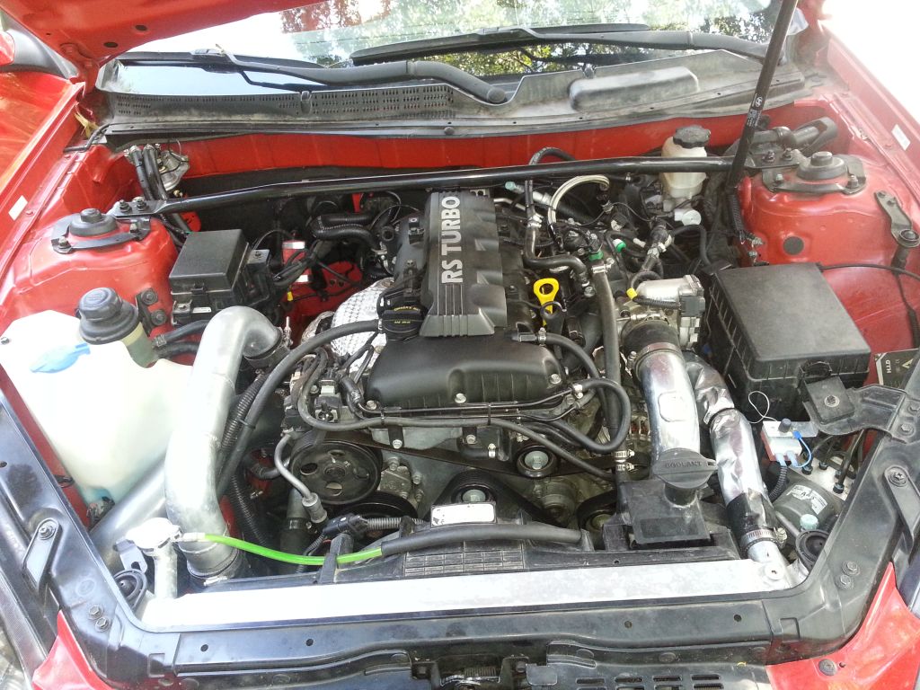

One thing I did is replace the black hose that goes from the overflow tank to the radiator cap neck with a clear one. You know in an instant if the system is working properly and full.
A brilliant and overlooked idea. I like it!

ha, every once in a while I can find an acorn.
This works especially well for those systems that leak such a tiny amount you may never know.
