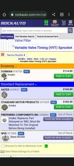

Do you mean the VTEC sprocket thing is causing the noise? This thing?
A long time for the revs to drop. Not to heat up. Thought maybe the revs hung for so long because it was trying to pump oil around
Uhh no. The engine management system keeps the idle speed higher to warm the engine so the emission control system can operate. If your engine speed is remaining elevated then the engine is either not warming up or it doesn’t think that it is. It will also inhibit the shift points of the transmission for the same reason.
