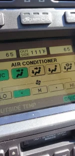

As boring as it sounds, I use a long thin pick to get lil pebbles put of the condenser. I do this while the oil is draining. No actual idea how effective it is, but it makes sense in my lil head. AC is pretty darn cold & I rarely have the fan on high...I like it cold too.
