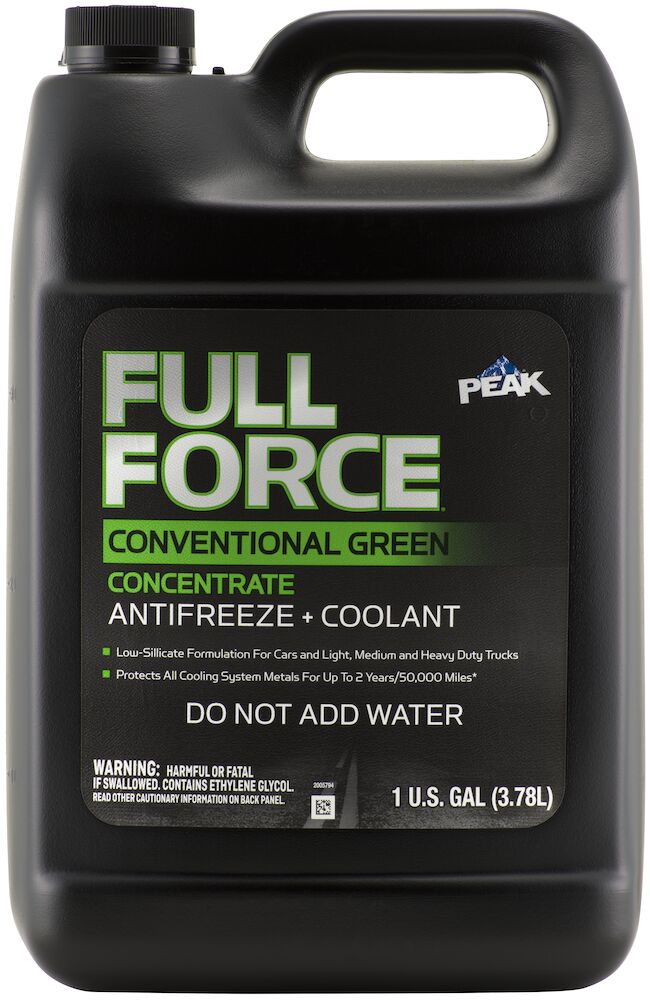

Or maybe Full Force conventional green.
https://www.owi.com/commercial/bran.../full-force-conventional-antifreeze-&-coolant

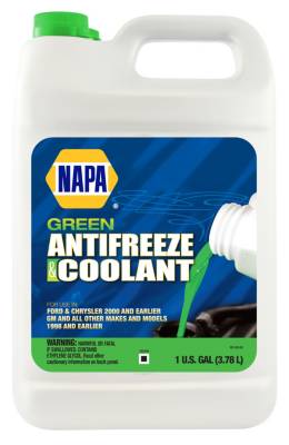

Napa still has a conventional green coolant. Not sure who makes it though.
https://www.napaonline.com/en/p/NAF1GAL
