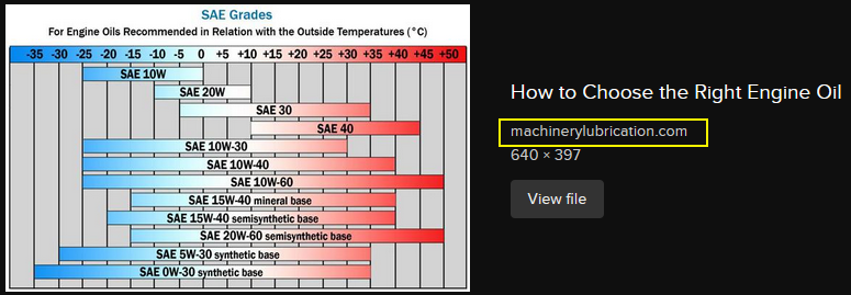

That chart doesn't appear to be from any owner's manual for a specific piece of equipment but rather comes from this article:
https://www.transdiesel.com/blog/diesel-engine-oil-blog
Actual owner's manual examples would be like this one from CAT for the 3500B/C engines:
https://drive.google.com/file/d/1uW6bjYDaN97_NmYZXq3Foa8P5TkgoD8V/view
You find that chart? On one website? And you claim it come from one article? Now that's funny.
I found it on another site, and it can be found on 10,000+ other websites out there, it's a generic SAE oil-temp chart, etc.
I opened the link to the image you used, which took me to that site. So yes, it quite literally, when you posted it, came from that article. Are you being intentionally daft or just don't bother to actually look at the sources from which you pull?
I really do like how you came up with some random number to support whatever point it is you think you are making though, and bravo for not addressing any of the material I posted, your trolling game is really on-point today. (y)
