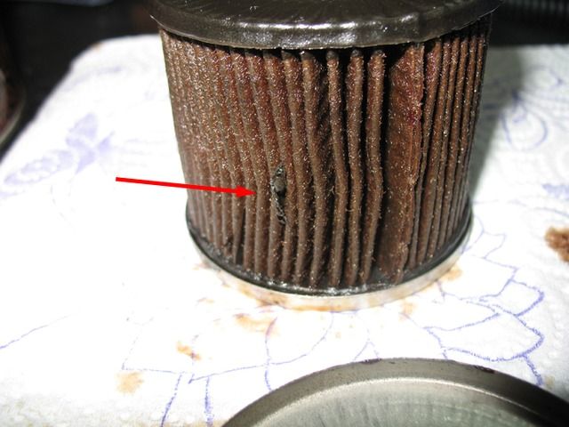

This is a Bosch Distance Plus P/N 3330 out of the LS400. This filter was in service for 5,889 miles with PP 5w30. It was replaced with a Denso filter.
After cutting the can open I put my finger in the center hole to remove the filter, the whole metal top of the filter came off.
The top came off as though it was just placed on top of the media. I don't know if I would categorize this as a failure. However, it's still kind of unusual.
The bottom end is attached (glued?) securely to the filter media.
Date code:
There's also a few pieces of what looks to be the stuff the filter media is glued to caught in the pleats:

No harm in the end cap falling off. The internal spring keeps everything compressed together.
As said though, this does make accepting fiber end caps much easier.
The adhesive is what would bother me. Since its in the media, that stuff was more than likely floating around in your engine. The filter did its job, but it could have clogged something too.
Yeah, just another example of the possible side effect of a failure. In this case the adhesive possibly getting into the motor.

The end cap shouldn't just pop off. That being said the glue/bonding looks solid on the filter media and the pressure from the leaf spring should keep the end cap in place during use.

Other than the super strong can, I can't really figure out what is so great about the Distance Plus-too expensive, too much Purolator, no full syn media. This one has decent media, but the glue stuff floating around is bad news, esp. if a bypass event occurs. Not good AT ALL!
