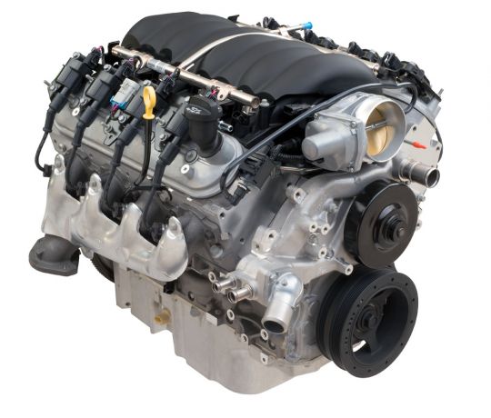

Hahahaha, and yet there is this:
[Linked Image from gmperformancemotor.com]
