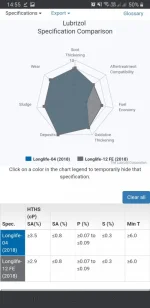

I just does not get it from specification wise. So far, my understanding was that FE specifications are not back compatible with simmilar non FE due to lower hths. Am I missing the point here?

In regards of LL04 vs LL12FE,what I dont get is how oil manage to have both? I have also diesel BMW requiring LL04,and so far I used 5w30, now considering switch to 0w oil.I found Mannol as best buy, and every 0w30 from their product range have 12FE beside LL04 (and of cours other from holly trinity).
I mean I understand that 12FE is requiring HTHS 2,9 or higher, while LL04 3,5 or higher, but so far my understanding was that the pount of FE oil is to have lower HTHS then 3,5..
By logic this oil should have min 3,5 hths, but whats bother me is the 12fe approval/recomendation. I also get the point of "higher", just I dont see how they manage to make FE oil with 3,5 HTHS. Do anybody have idea how is this possible?
It doesn't say "approval" or "Freigabe" anywhere on your attachement. For example VW doesn't allow for more than two approvals for one oil no longer, but there's three. VW changed this somewhat two years ago. I also doubt an oil can have BMW LL-04 and LL-12FE simultaneously. I would pour any oil into my car's engine from a company with such unreliable claims.
