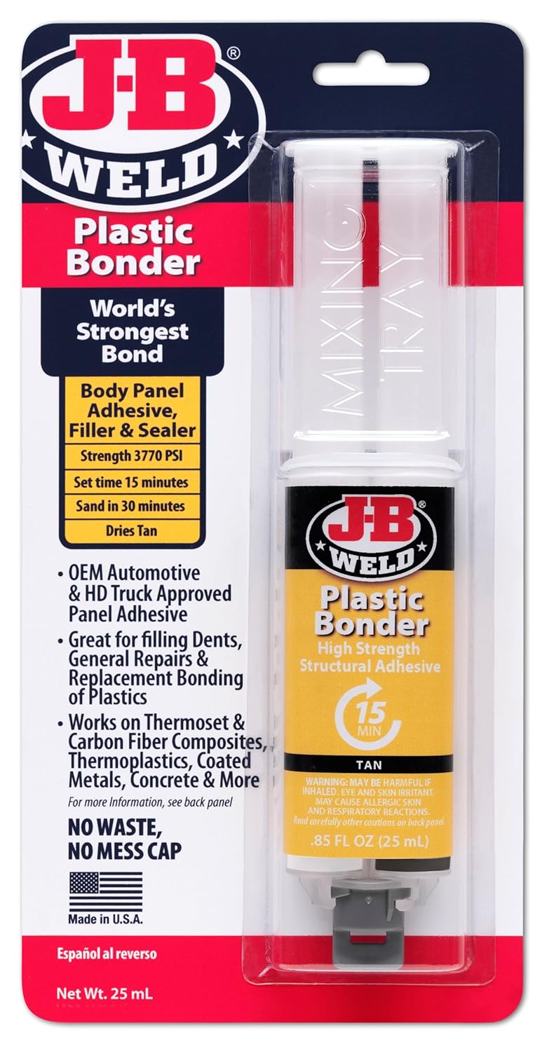

if they are halfway through.... some epoxy. Putty or 2 part your choice.
https://www.amazon.com/J-B-Weld-50133-St...r+Polypropylene
If the battery is old, I might spent the $8 toward a new one.

forget all glues.NONE will stick to polyproplene.

3M 4693 or 8005 are your best choices. Most box store stuff will specifically say that the use on pp and pe is dubious...
The jb plastic bonder claims to adhere to polypropylene, but i have not used it. I agree its tough for anything to bond. If its not leaking, i'd just redneck it with some duct tape.
