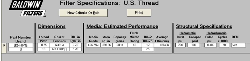

Here's some efficiency specs and flow for the B2-HPG. The HPG is a glass blend media.

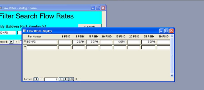

Flow, but I'm not sure what viscosity was used or what temp.
Originally Posted By: sayjac
Looks well made but you say it has thread end bypass, any way you could show that? I was under the impression that Baldwin (and Hastings) all had dome end bypass.
I see an extended portion of the centertube which holds the adbv, like many Puro's have, but no bypass apparatus (holes, spring, etc). Just wondering.
If you compare it to the non-bypass B43-S you can see a difference, I am assuming this is the bypass...
Actually I can't see the difference and I see no thread end bypass apparatus in either filter. Just asking to OP to show a pic down the center tube for a closer look.
Your pic show no thread end bypass either, just the centertube extention which hold the adbv.
Edit: When I zoom in I now see what may be holes around the centertube extention for thread end bypass.
The oil is probably relatively viscous since they show a 5 PISD with only 3 GPM of flow. Or, if the oil is pretty hot, then those filters are pretty restrictive to flow (relative to other filters).
The PureOne that Purolator tested for SuperBusa was showing 5 PSID with 12 GPM of hot oil at 200 deg F.
http://www.bobistheoilguy.com/forums/ubb...451#Post1619451
I would agree the oil is at room temp,cool.
