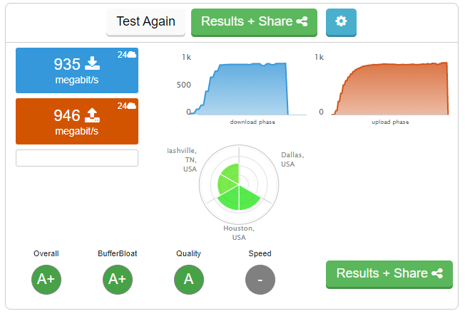

@OVERKILL - I am assuming this is pretty good for GB fiber:
