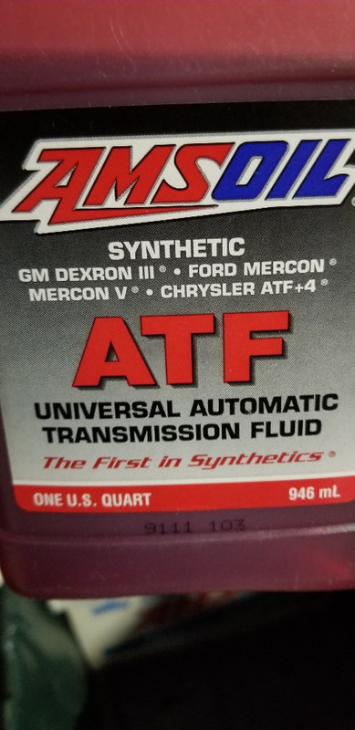

Amsoil - Good for Honda?
Garage sale finds?

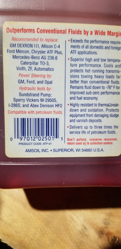

The second bottle is so old it doesn't even have a Honda Z1 reference nor MerconV.

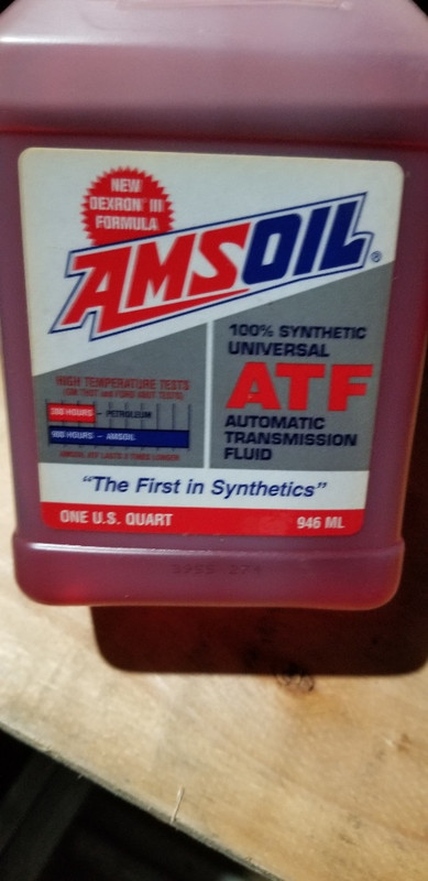

That Amsoil labeled it "New Dexron III Formula" means it's as old as a doctor in a cigarette commercial.
Use those products in an old pick-up truck.
I don't see where Honda is on the recommended list on those bottles. I'd go to the Amsoil look up and input all the information for the Honda vehicle and see what is recommended. If what you have there isn't recommended, I'd pass. That said, I'd have ZERO issue using the recommended Amsoil ATF for Honda vehicle with rec for DW1 or Z1.

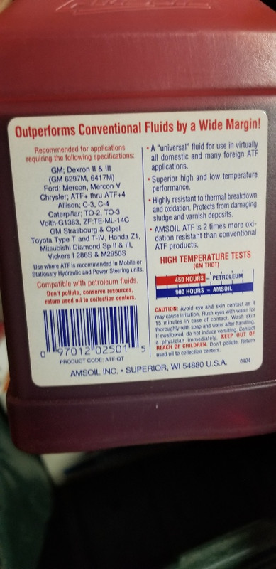

Always appreciate your input, if you look at #1 and 2nd pict, it says Honda Z1 on the back and hence the question :)
But will gladly pass on #2 as there is no Honda reference in it.

I have a bunch of the old stuff lying around that I used in my S4 tip. This was before it was the Signature blends. Not 100% positive without looking but they might be similar to the first pic. Got it probably around 2010-2011.
Thanks, curious to see if one from 2010-11 has the same label? It might be from that era then!
