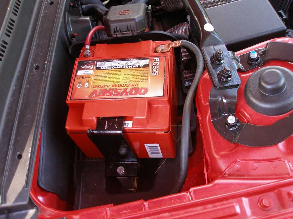

On 12/19/09 installed a 55Ah Werker WKA12-55P/FR AGM that was removed from a fire alarm panel at work. It is good for 550 CCA, and it cranks the Max faster than the old 525 CCA Exide did. Still cranks with authority.
Initial install.
Present installation.
5 years under the hood and two years in the fire panel havent hurt it a bit.
asand, I like your homemade terminal connections in the third photo. Were there already holes through the terminals, or did you have to drill them?
The only batteries I've had that grew fuzz were exide.
I avoid that brand like the plague.
The holes were already there. The posts have two flats that allowed clamps the quickly loosen, so I terminated the ends and bolted them on boat/truck style.
