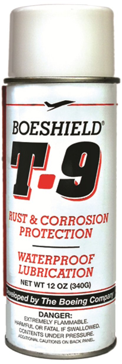

Boeshield T-9
http://www.amazon.com/Boeshield-T-9-Wate...9086&sr=1-1
+1 on trying Boeshield. Its good stuff and Boeing first developed it, thus the name.
But it may be "too" much of a coating for the sockets. Try it on one.
I spray it around my boat engine during winterizing.
Love boeshield but have found a rag soaked with fluid film a better bang for the buck to keep my garage tools wiped down. Just follow with a quick dry wipe.
