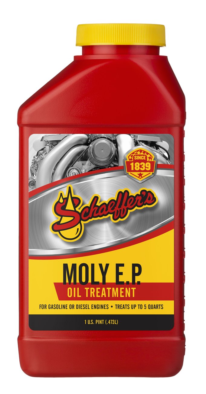

Originally Posted By: bmwtechguy
...Schaeffer Moly EP...
To which at Schaeffer's product are you referencing??
When he says Schaeffer Moly EP, I think he really means Schaeffer Moly EP.

# 132 does contain a VII and two friction modifiers, but this is not a Tackifier.
