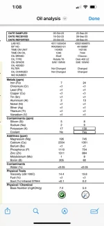

I have a 2018 Ram with the 6.7 Cummins. At 140k miles I got a code that DPF was at capacity. I contacted a DPF cleaner that told me that he could clean my DPF but he suspects we’ll find coolant in the DPF indicating a problem upstream.
I chose to delete the EGR and DPF. While doing this it was noticed that the coolant reservoir was a little low. I was told that the low coolant was likely due to a failing EGR (also causing the DPF problem). I’ve been worried that it may be a head gasket.
I sent in an oil sample with 7500 miles on it (5500 pre egr delete and 2000 post delete). The oil analysis showed high potassium (130). The lab indicated coolant in the oil.
I replaced the oil with T6. I took a sample at 1200 miles. This time the potassium is at 17 and the lab does not indicated coolant in oil.
Can I conclude that the EGR removal solved my coolant problem? Is 17 potassium too high for only 1200 miles?

It’s probably residual left from the last oil change. Run it longer and see if it increases.

Pretty likely only residual that didnt drain out. Its impossible to drain it completely. Good job with the fix. For 100% certainty do a shorter OCI and retest.
Pretty likely only residual that didnt drain out. It’s impossible to drain it completely. Good job with the fix. For 100% certainty do a shorter OCI and retest.

Up to you, as long as trend goes down that is what matters

Most times a blown HG on a 6.7 doesn’t put coolant in the oil. Also with the EGR cooler failure it usually goes to the exhaust and is “burnt” in the exhaust.
You might need to keep an eye for a different failure. Again I’d test at 2,400 miles and see what it says. $40 for a used oil analysis is minor compared to major engine repairs.

Thank you. I’m at 2440 right now.
Last sample I got was from loosening my drain plug. Is this ok or should I be pumping it through the dipstick? Or drain the oil and get it midstream?

When I have samples mid oil change I drive the truck to get it warmed up and stick a hose down the dipstick tube.
