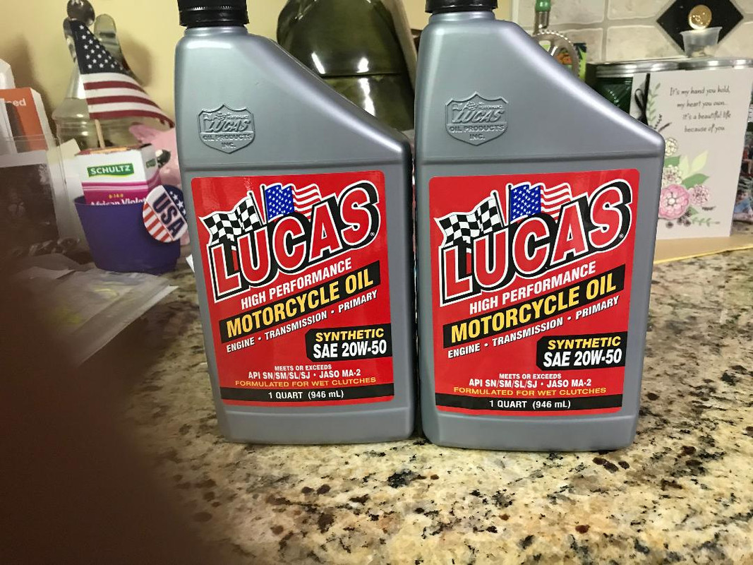

After I get my first free change of 0W-20 oil for my GR86 from the dealer I will drain 2 quarts and add the Lucas. A biker friend who owns7 Bikes recomended. He ls a serious guy. He is going to the salt flats next month and expects to get 220 or 250 mph. I forget which.
I prefer a heavier oil. Thats just me. I plan on doing a used oil analysis in 6K miles.
Buy a heavier motor oil. Mixing like this is probably not going to hurt, but not help either. The motorcycle oil probably does not have the FM additives that motor oil has, hence the " formulated for wet clutchs " statement. So you are diluting the motor oil FM additives , even though the motorcycle oil has more zddp.
Personally, I'd use a brand with a better reputation, but it's your car.
I won't let anything lucas near my engines.
Waste of money and probably worse than not doing it. This is assuming a GR86 means the Toyota CAR.
How is that relevant? Different vehicle, different application, different oil for it.
It doesn't get terribly cold in winter there in PA, so you don't really need 0W oil, but not terribly hot either, would be best off sticking with standard 5W-20 synthetic, not motorcycle oil and not 20W-50.
... unless you plan to race your friend on the salt flats?
You're putting ketchup on a filet mignon.

5W30 was the earlier oil recommendation in the 2.4T Subaru engine. A VW 504.00/507.00 or ACEA C3 oil would be a more logical choice than mixing 20W50 4T with 0W20.

People are giving you a hard time over this because Lucas Oil has been put through the ringer on here. Of the price you're paying for that junk, about half of it is going to cover their massive marketing campaigns. Thus, the dollar to product ratio is unimpressive. You also benefit nothing from the 20W-50, and the add pack isn't right for your application. There's just nothing sensible about this.
