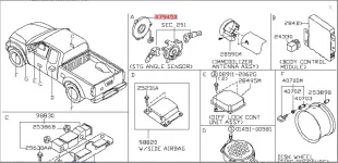

The steering angle sensor is a common Nissan part, P/N 47945-AS500. They're available at every Nissan dealer in the world. They're not free so expect to pay. The MAF issue might require the replacement of the entire throttle body. Neither of these issues that you mention are going to be cheap to fix so be prepared.

Like FowVay suggested above, I believe the clock spring is termed steering angle sensor in Nissan world. Not too long ago Eric O from SMA did a video on replacing one one an Xterra of the same vintage. I don't recall what the symptoms/issues were on that vehicle though..
