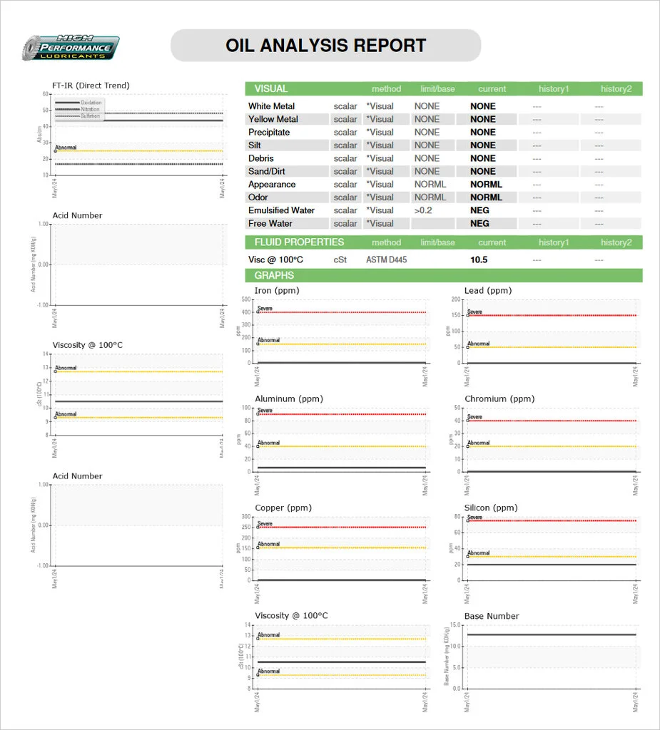

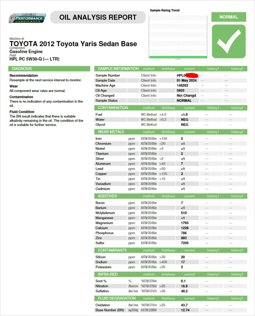

Report was completed at WearCheck, you can buy oil sample kits from @High Performance Lubricants which is a MOB2 kit for 35 dollars plus shipping.
This is just a base sample of how the oil held up at 5,000+ miles to monitor current engine wear and oil conditions undergoing extended drain trials. Car is driven 90% Highway / 10% City for the most part, 100+ miles round trip throughout the week. Only additive used was 2 cans of BG 44K in the fuel tank in 2 full fills. Oil filter used was FRAM FS3600 as an oversize so the total oil capacity was increased from 3.9 to 4.5 quarts. Air Filter currently has about 10,000 miles on it currently and was not changed.
full
full
Surprisingly enough the Base number is high or hardly taken a dent, even though 2 strong fuel additives was used during this oil service duration.
The Aluminum could be from the oil additives or pistons as it reads 7 PPM, the oil product data sheet says it has some aluminum as part of the additive package per HPL. Also surprised not to see any chromium (piston ring wear) despite very hard spirited driving behavior.
screen-shot-2021-08-21-at-7-03-16-am-jpg.67799
Let me know what your thoughts are.

Given how the oil held up aside from contamination, looks like the oil can have an extremely long life in normal driving conditions. The oil didn't sheared at all even after all that hard driving.

I’ve never seen mechanical shearing of the VM in my old 1NZ-FE. That engine is extremely easy on oil compared to other engines.
Your UOA doesn’t really show how the oil did. It shows that you have a well constructed engine that is operating properly, same as mine.
Silicon is high for the miles, and Al is as well. Some abrasive bearing wear possibly happening.

Its something im keeping an eye on. It does get fairly dusty in the highway due to ongoing custruction in the route i nornally commute to work and back. I check my air filter box every 5k and usually collects some sand at the bottom that I clean with a garage vaccum.
