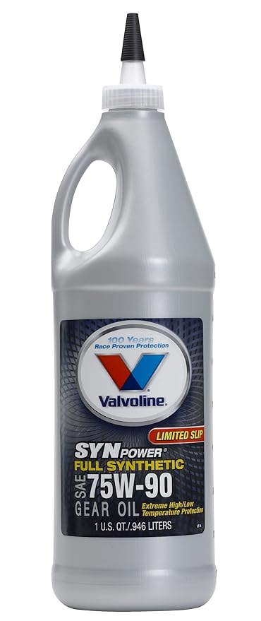

AAP has Valvoline SynPower 75W90 on sale right now for $10.49. Not cheap, but not a bad deal for a good brand. It is normally $12.99-$13.99 different places.

This was the 75w90 i was talking about. Which is non synthetic
[Linked Image]
Interesting, well I've used Valvoline syn in my old 4th gen 4runner and it was just fine, they seem to make a fine product so I'd use their conventional diff oil without fear
