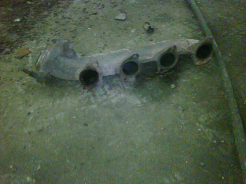

O......K. Well, this ended up being a "need a manifold job". The stud was broken. As was the one above it.
I didn't have the time and took it to Ford.
Here's what we found:
You can clearly see the leaks on #1 and #4 cylinder.
Other side is clean (right side) with not a hint of a leak.
Originally Posted By: Nick R
Which vehicle is this? Town car or expedition? And yikes.
Expie. The 4.6L and 5.4L in the trucks are known for cracking exhaust manifolds and broken studs.
My parents had their manifold (same side) replaced 2 years ago because it cracked.
Mine didn't crack, but the studs broke.

You get new headers out of the deal. Those are pretty nasty.
