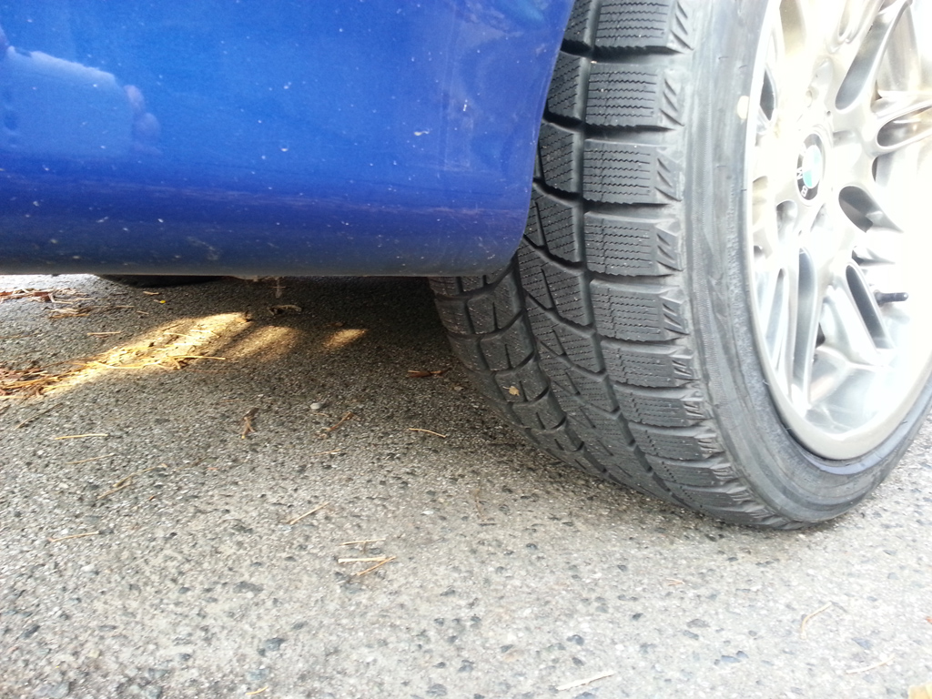

I wonder just how much snow/ice/slush traction and control is given up by stretching narrow(er) winter tires over wide OEM size wheels (due to sidewall stiffening) like I do when I use winter tires?? (225/55-16 on a 16x8 wheel)
Originally Posted By: HTSS_TR
Looks like front and rear are different tire, not the same brand/model.
Same brand, and same family (Blizzak) but different model. The fronts were a lightly used set that they had in stock, the rears are quite obviously brand new.
