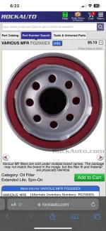

Pronto below is the PG2500ex afaik .
Wait does that Pronto box really say "Particles LESS than 30 Microns"? I think it's supposed to say MORE than?

I think you’re right about the Premium Guard & the Pronto being the same filter. It shows the PO2500EX as the alternative part #. I only buy filters from RockAuto if I’m also ordering other parts from them. Otherwise you can get them with free shipping from Walmart+ or Amazon Prime, whichever you have.
I'm currently running a "Pronto" that's made by Premium Guard so they apparently have some at least sourced that way.
Premium Guard lists some, but not all, of their sub brands on the main PG site. They do not include house brands like Carquest or MicroGard though but they are easy enough to spot.
