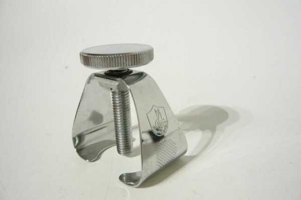

Maybe it was around 2000, I got back into riding again and I got this Record hub from eBay. It was really nice, but it did have that really funky dust cap that needed a special tool to remove it without scratching up the aluminum. Well - I tried taking it off without it and now it's scratched. Funny you mention Sheldon Brown indirectly. I asked on one of the Usenet groups about that thing, and I think he answered that it was a real fiasco of form over function. This was the tool:
