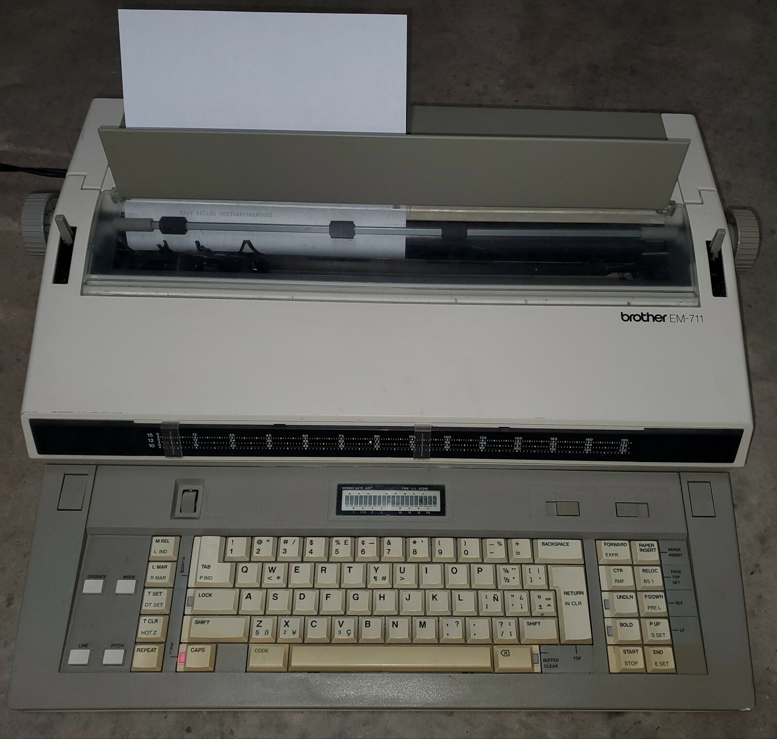

I know what people here are going to say, who uses a typewriter these days. Well, how else would you fill out forms, often with duplicates attached.
Anyway, this is a Brother EM-711 from the late 80's that worked great until tonight. Was filling out a bill of sale and it would reboot every few minutes, as if it was turned off and on. The last time it wouldn't turn back on at all. Totally dead. Any suggestions? Does anyone repair them? Actual parts are probably not available.
