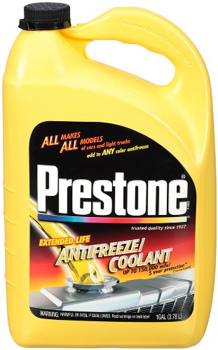

The Prestone All makes all models looks very close to conventional green but its not as opaque. I'm using that in my Nissan now mixed with conventional green.
Originally Posted By: BigD1
That Prestone is just another Dexcool clone.
Well they changed the formula recently, so not 100% sure if it still is or not...
This is the new one
This is the old one....

There is a thread here on the forums, and a member asked Prestone if the new stuff still has 2eha in it, and they said yes it does. Until I see a MSDS that I can not find on Prestone's website, then it still has e2ha. At least on Peak's website, the MSDS is easy to find. Prestone does make it easy to find the certificate of compliance--information I don't need.
