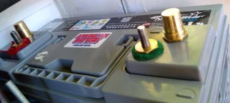

I'm not sure which bronze or brass Alloy Northstar uses, Silicon or Phosphor bronze I expect, but I recently polished the terminals with Caig Deoxit d5 and 1500 grit wet sandpaper and they glow like oiled gold, becoming far brighter with the D5 than when I used the 1500 paper dry.
I bought and applied some NO-OX-ID which says it is a conductive grease, but my friend who is more OCD than myself about minimal contact resistance swears by KOPR-Shield which he thinks is the same or at least very similar to copper antiseize.
Before I added the No Ox ID, but after wetsanding with D5, I tested the max output of my alternator into this well depleted and still healthy beast of a TPPl AGM battery( 116 amps) and then felt the terminals for heating. At that point I noticed I forgot to tighten the post clamp on the negative.
It still remained cool to touch and sams as ambient according to my IR temp gun..
