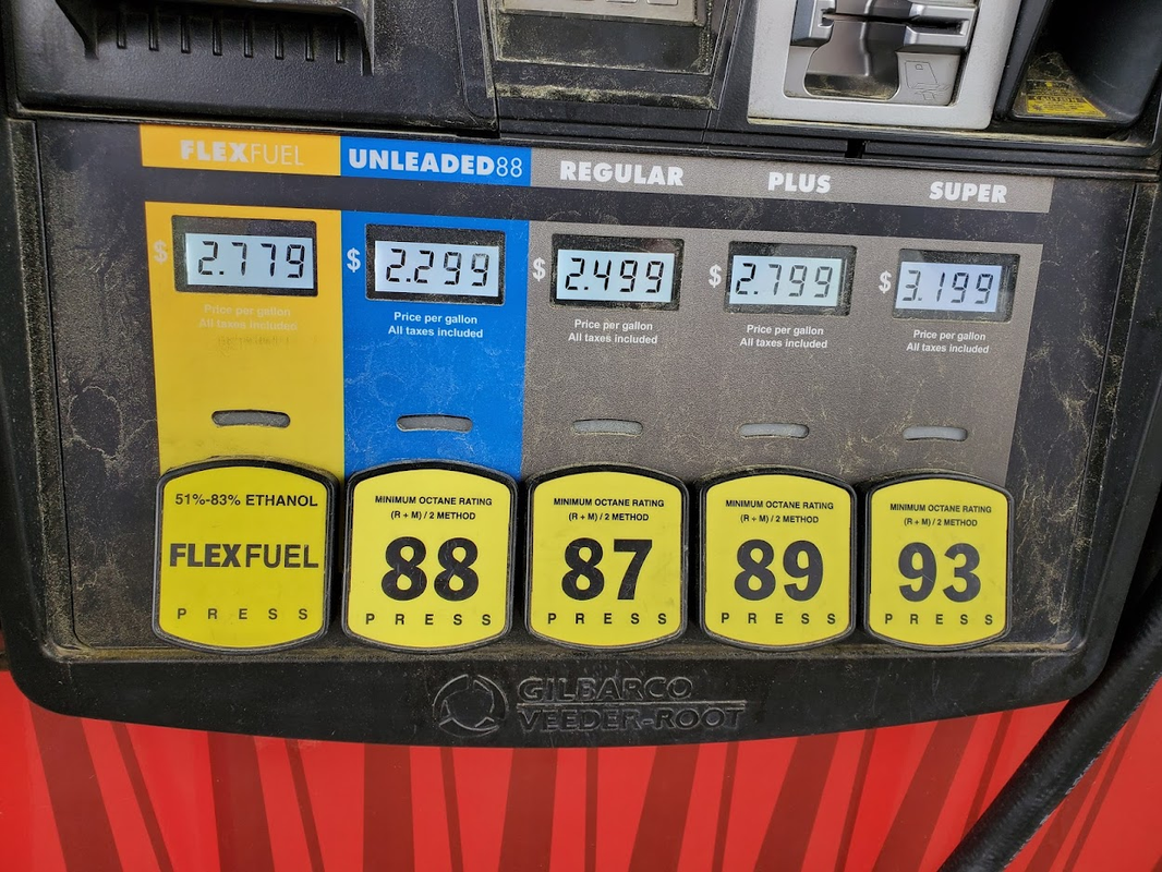

new sheetz just opened in buckhorn, pa + it was MOBBED with reg 89 @ $3.30, seen the flex fuel as well + interested in adding some to my 2001 TT with an APR 93 oct tune as i see some knocks detected in my VagCom software.

pump says 51 to 83 not E-85 so i got an ethanol tester but what % eath relates to what octane? been reading that 30% is safe for anything not too old + after 30% eath the benefits are not as much but they are there + its noted are your injectors up to higher outputs that come with tuning for eath. interesting to me + my basically stock 2001 TT 225Q with APR tune, bigger exhaust + better air intake. car is my fun summer ride + is a garage QUEEN in winter except for an emergency as my 2011 fronty SV 4 wd 6 spd man + 4WD serves me well in winter + light hauling duty + being retired i dont drive a lot.

I've tested it - it's ~E85. I run 2-3 gallons to a 14.5 gal tank in my Unitronic tuned Sportwagen. It runs so great with it/zeros out my knock.
