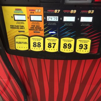

I live in Northern Va, and at many of the Sheetz locations they have “ flex fuel” in the yellow pumps. They list it is E-51 to E83. Some locations list it at 94 octane, some simply have a “ flex fuel” sticker on the product button.
I know the ethanol content varies with the seasons but what would the octane rating be with say 51% ethanol vs the 83%?

But they don't say what the octane rating is if there is only 51% ethanol.
I'd assume it's the the low end of the range. And possibly at such high octane rating numbers, the model for octane rating blending isn't as linear as it is for blending 87 and 91-93 octane fuel to make 89.
Again, I'd some would be happy with the lowest ethanol content because it will result in more miles per gallon, but others want the highest because it results in higher performance. I heard that in some countries, E85 is always at the maximum and it can be relied on to provide the highest performance. Certain it would be great for those going to the track.
This is only RON and not (R+M)/2 and doesn't explain that the base gasoline is, but it does seem to indicate that octane rating goes up clearly. The math does make sense to some degree. There's less of a number increase for each 10% (or so) more ethanol by volume.
Down in Richmond area with multiple Sheetz locations having it. I love the stuff. I use 2-3 gallons blended with 93 for extra knock protection/timing advance in my tuned VW. I assume it's 81% as stated for my math on the blend so I will always be at or under my target ~20-25% blend. As to octane, no clue...pumps here say 94 but of course that will vary on the E content. Some folks have tested it here and it was testing at the stated ~80%.

Sheets E30 is 88 octane. I used it in my 2020 Equinox 1.5t on a trip from NY to SC. It got the best mpg during the trip.

Why don't they put the minimum octane rating label on their E85 pump like they do on their E15 which is rated minimum 88 octane ?????
Thanks.
That's not a legal requirement, and it will vary by up to 5 numbers. But at the minimum it's going to be 100 AKI.
