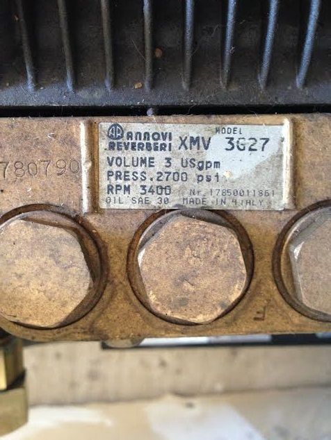

I inherited a Excell/Divilbliss Honda powered pressure washer that I believe is a heavy duty commercial unit based on what the local OPE shop told me about it. I'm doing some maintenance on it and had a few questions. What kind of pump is on this unit and is it any good? The shop had the below oil and said it was the correct oil for the pump. I just want to confirm because the bottle says it is for triplex plunger pumps but I cant find that printed on my pump anywhere. Is this the correct oil for this pump?
Also should I use the sight window on the pump case to check correct fluid level or the dip stick? The reason I ask is because if the sight window is up to the middle line there will be no fluid on the dip stick. I have to fill the pump case till the sight window is 100% full till I get a fill reading on the dip stick. What is the correct and safest reading of the fluid level?
Last question: is German Castrol 0w30 a good choice for the engine? I figured it was like a Honda mower engine and GC 0w30 is good for them! Thanks for the help!!!

click on pumps on the left. Then go to page (6) It will show that pump.
http://www.annovi-reverberi.com/AR-PUMPS/servicedealers/SD California.html

A few things to keep in mind. Some of those pumps don't have a pressure relief mechanism, so if you're moving the machine around on a job site either shut it off, or trigger the nozzle on the wand at least every 30-60 seconds. The pump uses non-detergent straight 30 grade oil, or pressure washer pump oil. They strongly advise against using multi-grade engine oil with detergent in it, although some people do.
Your pump is low on oil. Check the sight class on level ground, and fill it to the center between those two points in the metal on the sight glass.

Yes that is a triplex pump. Yes that is the correct fluid. Use the sight glass between the two "arrows". Currently, your pump is low on fluid.
As for the engine, pressure washers run with an incredible load. I like 40 weight in them myself. 5W40 if you like synthetic or 15W40 if you prefer conventional.
GC 0W30 is a fine oil, but I'd prefer a heavy duty engine oil such as Rotella syn blend 10W30 if you prefer a 30 weight.
That's an AR pump.....very good pump. I just replaced an old pump on my Karcher with a 4000 psi AR, I love it.
I would just order a bottle of oil online, they are avail and it's better to go with the manufacturer's oil.

No Water in the pump. I just changed the oil before that picture was taken and it is blue in color.
